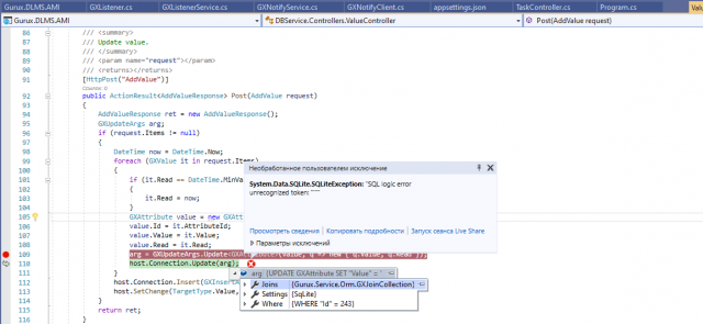

About the arg =
arg
{UPDATE GXAttribute SET "Value" = '
Joins: {Gurux.Service.Orm.GXJoinCollection}
Settings: {SqLite}
Where: {WHERE "Id" = 243}

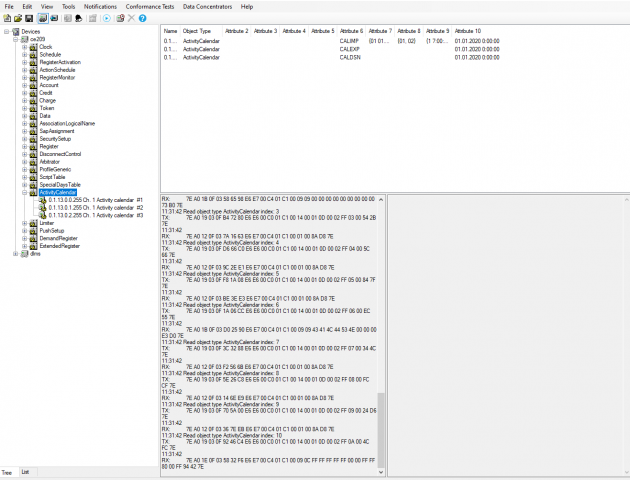

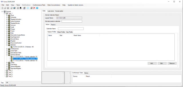

The object is highlighted in the picture. I tried to read it.

I tried to read ActivityCalender 0.1.13.0.1.255
Marked in the picture. Connected to the meter, selected the object, tried to read it.

As an example - I tried to
As an example - I tried to read Atbitrator and ActivityCalendar after that.
In ValueController.css in line 110 for ActivityCalendar got error. The same as above.

For ActivityCalendar (where the error occures):
{UPDATE GXAttribute SET `Value` = '
And nothing more.

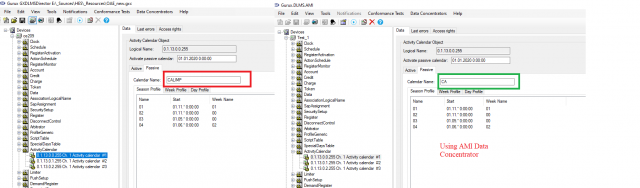

Everything is ok using web.
Everything is ok using web. But problem using Director (with Ami).
Director without Ami reads full name of the calendar. But if we start to use Ami for reading - only first two characters.
Picture attached.
6 years 2 months ago
I know the reason for this. We are implementing GXDLMSDirector UI so it can show non-ASCII Activity Calendar names.
