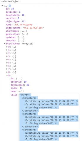

I am trying to use ami on a web. Tell me, please, can I use existing methods for packing the data before send it to write in ami, as well as for unpacking complex data (such as structures, arrays), which are receive as xml in ami?
As far as I understand method ValueToXml receive only symple type.
6 years 3 months ago
ValueToXML support also complex data types. Use it to convert value to XML format.
