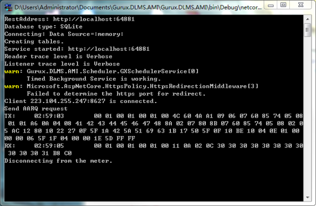

I currently have a GPRS meter
I currently have a GPRS meter that connects to the port the gurux AMI listens on. I want to know, how to use GXDLMSDirector to read the meter information through gurux AMI
