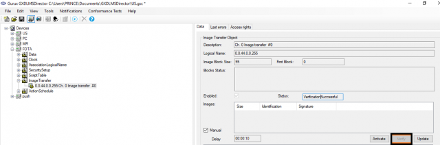

The Image verification (mannual) problem
Hi mike,
When I am trying to do image transfer from the mannual mode after selecting the mannual way for image transfer.The Verify method select or access is not getting enable even after giving the access to all the method of the FOTA. and image transfer I have highlight that option in the image
7 years 6 months ago
Verify btn is disabled if the image is already verified. Status in your image is "Verification Succeeded.
Now you can only update a new image or activate it,

Hello mike,
Hello mike,
Even if the verification successful is not present the image is going for activation and that verify button is not getting enable even if the all the method have their desired access
7 years 5 months ago
What the status is?
