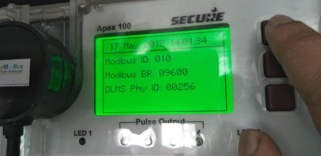

i used secure apex 100
http://securemeters.com/index.php/products/generation/apex-100/
please tell give me sample code for this.
i got data at cient address 10 server add 1.
but meter show DLMS phy.ID : 0256
how i communicate i want load servey & instant. param value date wise.
i can see obis code in meter but program give me unavailable code.
i got fallowing log:
i change o/p display

secure apex 100 meter
Change serveraddress size to 4.
Use GXDLMSClient.getServerAddress(256, 1) -method to generate right server address.
dhirajthaokar
8 years 6 months ago
thanks for reply
when i used GXDLMSClient.getServerAddress(1, 256,4) ;
i got server address 16640. using this address i got above same o/p
