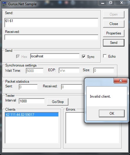

  3. Getting Invalid Client Exception Whiling Reading Meter Over GPRS
Getting Invalid Client exception whiling reading meter over GPRS
By erdeepakcs , 27 March, 2018
Gurux.Net
i tried to read meter over GPRS, meter is connecting successfully to software, but when i send command to read it, i am getting invalid client exception from software.
Please check the screenshot below.
