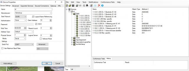

Tried today to hook up to kamstrup 382Mx7 Omnipower meter.
Got connection and could read meter ID:
Ch. 1 Electricity ID #2 29483406
Ch. 1 Metering point ID #1 29483406
Ch. 1 Active firmware identifier 5098684-AH1
, but not much more.
Will try some more later.
Brgds
Lars
GXDLMSDirector 8.2.1907.2501

Gurux.DLMS.GXDLMSException: Access Error : Device reports a undefined object.
ved GXDLMSDirector.GXDLMSCommunicator.ReadDLMSPacket(Byte[] data, Int32 tryCount, GXReplyData reply)
ved GXDLMSDirector.GXDLMSCommunicator.ReadDataBlock(Byte[] data, String text, Int32 multiplier, Int32 tryCount, GXReplyData reply)
ved GXDLMSDirector.GXDLMSCommunicator.ReadDataBlock(Byte[] data, String text, Int32 multiplier, GXReplyData reply)
ved GXDLMSDirector.GXDLMSCommunicator.ReadDataBlock(Byte[] data, String text, GXReplyData reply)
ved GXDLMSDirector.GXDLMSCommunicator.KeepAlive()
ved GXDLMSDirector.GXDLMSDevice.KeepAlive_Elapsed(Object sender, ElapsedEventArgs e)
6 years 11 months ago
Hi Lars,
Hi Lars,
Please, start a new thread when you have a new question.
Logical Device Name should be mandatory, but it's not implemented for your meter. Keepalive tries to read that, but it fails. The meter should implement this, but we'll try to think something so solve this.
