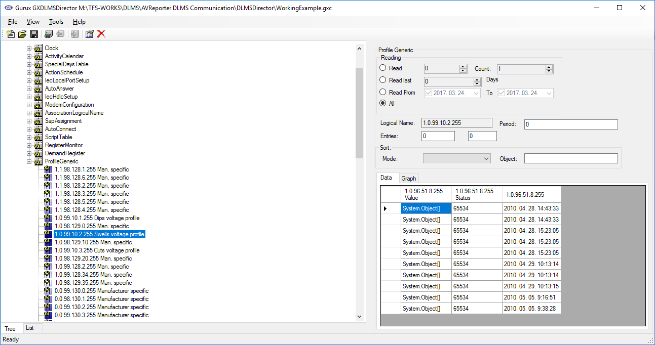

I try query the data with GXDLMSDirector and its working (please see attached image).
I would like to get the same table in .NET environment.

No problem, thanks for the fix. Now I can receive the result, but can you help me please identify the byte array result? The status and datetime are clear, but what can I see in the other array indexes? (I mark with blue lines in the attached image).
If I good understand, I can get only "ALL DATA" from SL7000 (profile generic), I cannot receive data between dates? The Gurux DLMS Director shows an error if I query between dates: "Access Error: Device reports scope of Access violated".

SL7000 is using profile generics inside of profile generics. For this reason you can see Array of objects.
Structure is describe on LogicalDevice SL761 document. You should ask that from the vendor.
All profile generics are not support read by range. You can example read Billing period 2 (0.1.98.2.0.255) using dates, but there are other tables that are not support it.
