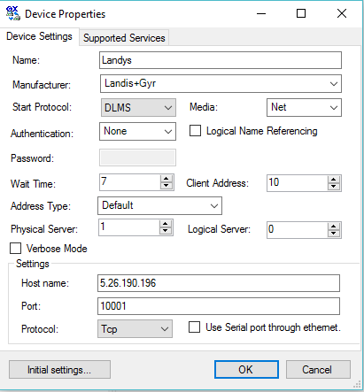

I did read Landys successfully with DLMS. But sometime (mostly) reply with error.
"Connection is permanently rejected. The application context name is not supported."
I restart meter then normally reading, but second try reply this error.
thanks
9 years 9 months ago
Landis Gyr E650 ZMD405CR
Change "Use Logical Name Referencing" check box.
savasgultekin
Thanks for all. :) I did it.
