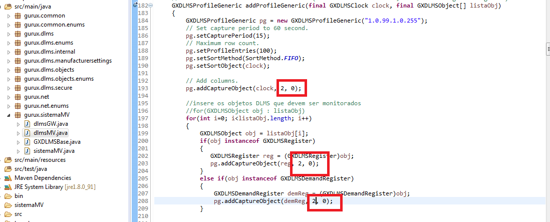

I'm implementing dlmsserver using gurux java. I first create a register, a demand register and a clock. Then I add them into a profile generic object (see print1). When trying to read profile generic values from guruxDirector, it says "Number of columns do not match".
Please, help me. Am I adding the captured objects wrongly?

When you read your data number of columns is not equal to columns you describe here.
Colums are correct. Are there any rows on buffer?

I got it Mikko!
I got it Mikko!
Buffer was being initialized with only two columns. Now I changed it and is now workful.
