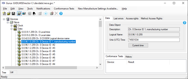

Hello, i tried to read Data object via GXDMLSDirector and it was okay. But when i tried to read it with .NET library it was exception "Exception response. "Service not allowed"-exception. Operation not possible".
GXDLMSData _data = new GXDLMSData("0.0.96.1.0.255");
_сlient.Read(_data, 2);
I did not read association, so i think is there missed parameters in GXDLMSData instance that i need specify?

As you can see in the…
As you can see in the screenshot in the first message, the association was successfully read when first connected via GXDLMSDirector. I can't understand why it's not being read through the library.
