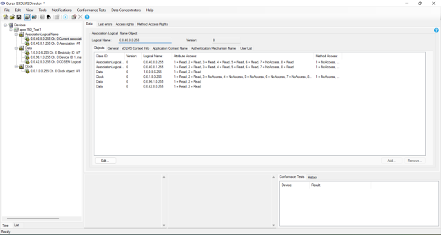

Hello, We can't read meter…
We can't read meter-capable data(Ex. Voltage / Current ).
Please share the step-by-step procedure to read all available parameters.
Also can't add manual objects ( under the Content Info option. )
suri371994
3 years 9 months ago
In reply to Hello, We can't read meter… by suri371994
Current Association
Current Association
