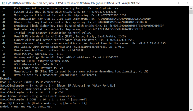

The connection fails because your device settings are different than the meter expects. When you select the meter in GXDLMSDirector, you can see the correct command-line arguments that you must use.

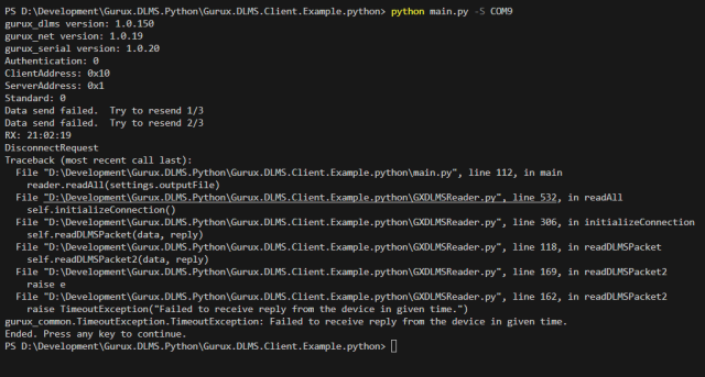

Hi, The python version is 3…
The python version is 3.12.3. The screen shot is attached. I don't get your point about the windows language.
When I used raspberry Pi to read meter using RS232 then it was reading some responses by proving only one resource that is COM Port. I have also tried with setting used in DLMS Director, but it did not work.
I have also tried in separate PC having windows 11 and python version 3.12.3. There I was getting port names but the response for SNRM Packet was not coming. And after three retry count I receive some response bytes in RX buffer as per the attachment.

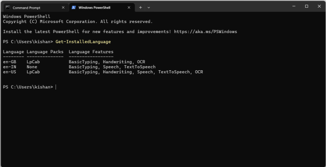

I checked this from the source code and noticed that it expects that Windows is using Unicode format.
Can you start Windows PowerShell.
Then run this command and add the results here.
Get-InstalledLanguage
This affects only how available serial ports are shown. You can use the client application if you set the correct settings that GXDLMSDirector shows.
2 years 6 months ago

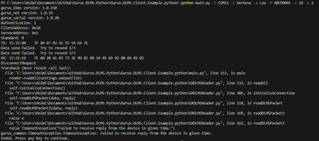

Hi, Can you add this to get…
Can you add this to get a better trace:
-t Verbose
I can see that the meter is using a different server address. What server address are you using in GXDLMSDirector?

Hi, Check the response for…
Check the response for installed Language

Response after adding -t…
Response after adding -t Verbose and using the correct details as used in DLMS Director.
