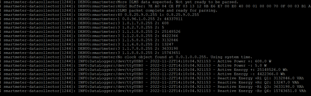

Actually, things are working fine now.
here is the log from the smartmeter-datacollector
https://gist.github.com/kafisatz/c347b19b5d0abac58345ddab880b1659
Maybe the hex data in my previous message was incomplete (sorry about that).
But can you please tell me how you know that there will be 'more data'?
clearly the smartmeter-datacollector is aware of this as well: there are always three messages which are concatenated (e.g. line 13).
Interestingly my meter is only sending the tariff information ("Active Energy + Tariff 1") once per minute. All other data is sent every 5 seconds though.
