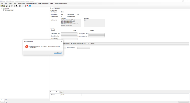

When password is correct everything works fine. But when i tried to pass incorrect password exception has been thrown at this line:
SecureClient.ParseApplicationAssociationResponse(reply.Data);
With the message of "Unable to cast object of type 'System.Boolean' to type 'System.Byte[]'."
I checked reply.Data.Data array. There were these bytes: 03 00 C1 00 01 00 03 00.
Can you please explain how to handle incorrect password?

System.InvalidCastException: Unable to cast object of type 'System.Boolean' to type 'System.Byte[]'.
в Gurux.DLMS.GXDLMSClient.ParseApplicationAssociationResponse(GXByteBuffer reply)
в GXDLMSDirector.GXDLMSCommunicator.InitializeConnection(Boolean force)
3 years 10 months ago

System.InvalidCastException: Не удалось привести тип объекта "System.Boolean" к типу "System.Byte[]".
Could you please list the reasons why this could happen?
