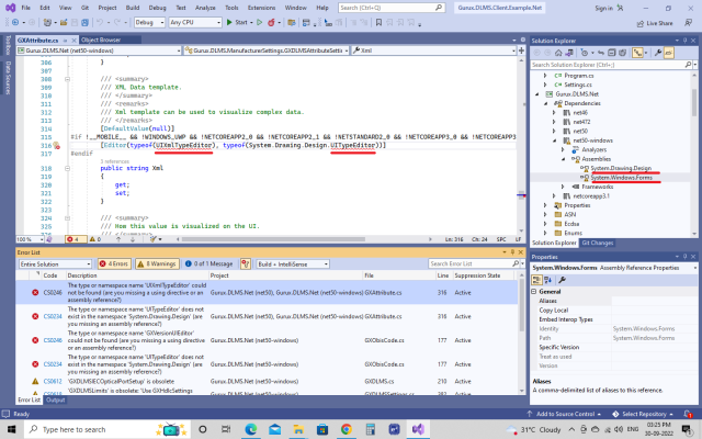

Hi All,
I have download gurux.net from github and tried to open the c# example in VS2019 first.
Well, the build failed as VS2019 has no support for .net6.0 framework.
So i installed Vs2022 and now the project is not building and says "System.Drawing.Design" and "System.Windows.Forms" is not supported in net5.0-windows.
Error Code: CS0246
Error Description: The type or namespace name 'UIXmlTypeEditor' could not be found (are you missing a using directive or an assembly reference?)
Error Code: CS0234
Error Description: The type or namespace name 'UITypeEditor' does not exist in the namespace 'System.Drawing.Design' (are you missing an assembly reference?) Gurux.DLMS.Net (net50), Gurux.DLMS.Net (net50-windows)
Does anybody come across this error?
How to include the assembly reference, in other words how to resolve the error?
