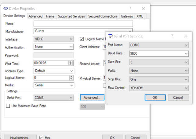

i am enable to find DTR control configuration in Gurux DLMS director . Basically to enable and disable DTR signal manually.
I was hoping it should be provided under Flow control tab , but options there are not clear to me.
Kindly provide info on how to control DTR signal in Gurux DLMS director Serial configuration.
4 years 1 month ago
DTR is enabled automatically when the serial port is open. You don't usually need to change that. Do you have any specific reason why you want to set DTR manually?
vishvender
4 years 1 month ago
Hi ,
Hi ,
Mikko ,Yes in our application we have to support various serial communication cables (especially optical cables) ,among them few are customized in a way that we need to control DTR .
So to support all we require to configure it. Is it possible to add that in Gurux DLMS director ?
Vishvender
4 years ago
This might cause problems with some of our clients and for that reason, DTR handling it's not possible to add as you described.
