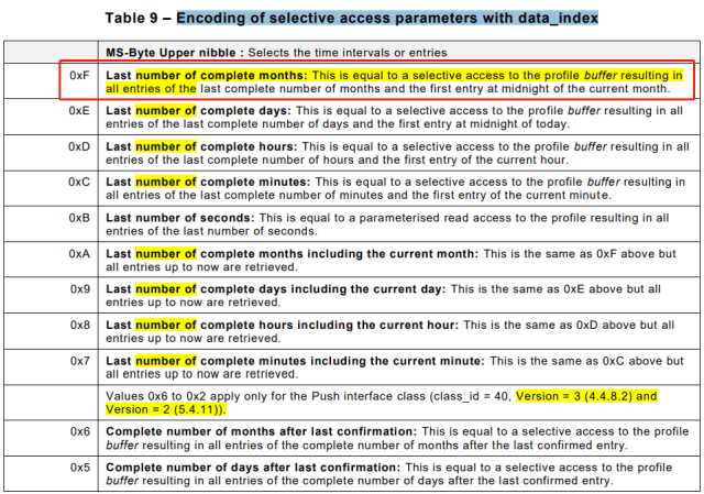

  3. Encoding of Selective Access Parameters With Data_index
Encoding of selective access parameters with data_index
By Laura Chu , 7 September, 2022
I have a question about ’Encoding of selective access parameters with data_index‘. If the data_index is 0xF302, which entries are selected?
For example, the timestamp of the entries for the current month is as follows:
09/05/2022 10:00:00
09/05/2022 10:15:00
09/05/2022 23:45:00
09/06/2022 00:00:00
So the selected entries are all entries in the last 2 months, or all the entries in the last 2 months and the entrie with a timestamp of 09/06/2022 00:00:00?
If there is an entry with timestamp 2022/09/01 00:00, then whether the selected entries are all entries in the last 2 months and the entry with timestamp 2022/09/01 00:00?
