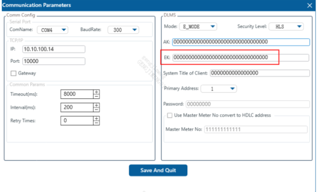

I have EK and AK password from manufacturer (see picture below)
I am trying to make time syncronization. However I am getting ArgumentOutOfRangeException.

There must be 16 bytes. You must also give it as a hex, not ASCII.
GXDLMSTranslator.HexToBytes("00000000000000000000000000000000"):
hhkx
4 years 2 months ago
Actuallay manufacturer sended me it as 32x0. But with your suggestion I made them 16x0.
