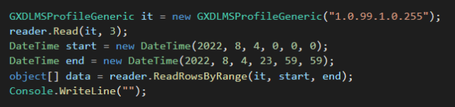

Hello. I am developing a function in .NET for an Iskra MT880 meter. I have already initialized the communication with the meter and I would like to know how to obtain the data of load profile 1. Currently I have the code like this but it throws an error: "Capture objects not read"
I'm new to DLMS/COSEM and I can't understand it very well. I appreciate your help in solving the problem.
*** already solved ***
After declaring the variable "it" put "reader.Read(it, 3)". After store in a variable "object[]" which returns the function "ReadRowsByRange" to see the data.
3 years 11 months ago
I'm glad that you solved this. I'll add the answer here anyway.
You need to read capture objects before you can read the buffer.
