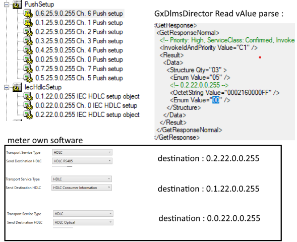

Hi, when I want to set Destination properties of GXDLMSPushSetup when ServiceType is Hdlc ,
gurux change obis code to Ascii format and write something like :
<!-- 0.2.22.0.0.255 -->
<OctetString Value="302E322E32322E302E302E323535" />
but when I use meter Own software to set this property it's write obis logical name as hex value like :
<OctetString Value="0002160000FF" />
I wanted to know which format is correct and also is there way to force gurux to write it as hex not ascii?

I think because this meter
I think because this meter wants to enable push setup on Optical and Rs485 port simultaneously,
it used such mechanism. I upload this meter Obis list for Push setup and iecHdlcSetup in below.
my problem is that destination field type in dlms blue book is OctetString. and you use Ascii for it value setting. but also you can parse hex value Correctly when I read value with GxdlmsDirector.
I think when you writing value for destination when service type is hdlc , you should write it as hex value and not ascii value
