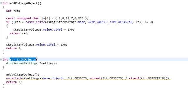

I have added changes as below
Please can you let me know is it correct or not ?
Firstly I need only voltage related changes. So, I have added Voltage object in const gxObject* ALL_OBJECTS[] as per attached image [AllObject.jpg]
After that I have added voltage object with "svr_InitObjects" as per attached image [svr_InitObjects.jpg]

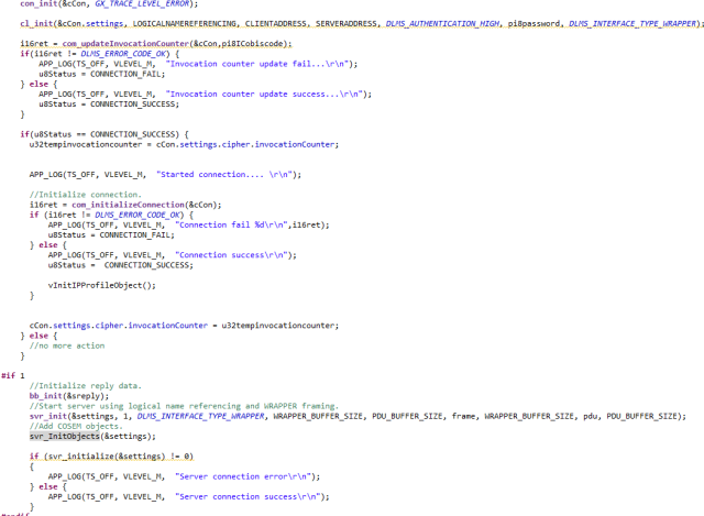

Next I have init server and client connection. Client got connected successfully with meter.
Please find attached image [ServerClientMeterConnection.jpg]

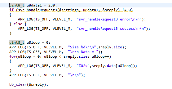

After that I am trying to generate frame from server based on fixed value of voltage.
But not able to generate frame.
Please find attached image of code [TryingTogetFrameFromValue.jpg].
Vitaol
4 years 5 months ago
Hi, I don't fully understand
Hi, I don't fully understand what are you trying to accomplish, but as far as I understand (I’m not related to gurux) svr_handleRequest3 it’s not going to generate a frame from a value.
If you want to read the voltage you should request it from the client, here you have an example:
https://github.com/Gurux/GuruxDLMS.c/blob/cf7c1bdd47287ac0a95fb439b1207…
And then the server must use the method svr_handleRequest to analyze the request and generate the response frame for the voltage.

If I understand correctly you
If I understand correctly you want to read the value using the client and save the value at the server.
You can pass the value by reference in the addvoltageObject method with the macro GX_UINT32_BYREF and pass it the pointer to the variable where the client store the value.
Example:
In the example the activePowerL1Value variable is passed as reference, this way whe it values is requested it's always updated.
Vitaol is correct. You need to implement both the server and the client. When svr_preRead is invoked you need to read value from the meter and server returns that read value.
Value is updated to e->value. You also need to set e->handled = 1.
Check how clock is read and implement it in the same way.
