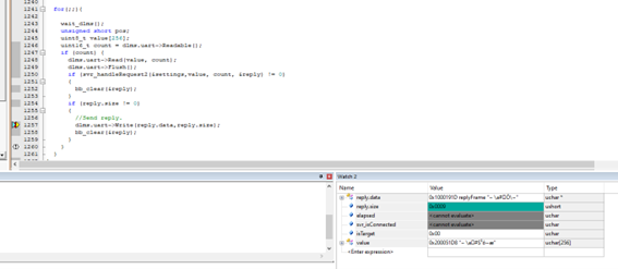

I’ve been investigating a bit more and found this thread:
https://www.gurux.fi/node/16016
It’s very similar to my problem, in my case when I connect to meter A the meter B reply even if it’s not the target. In the screenshot isTarget it’s a global variable with the same value as ret in isTarget.
As you can see the reply has size != 0 even if the meter it’s not the target.
https://imgur.com/a/kSCjTpS (screenshot)

4 years 1 month ago
I did another test, I configured one meter (meter A) isTarget method to always return 0 and it still reply to the other meter (meter B).
The step by step is:
Set a breakpoint after svr_handleRequest2 method and before sending the reply by uart in meter A.
Connect to meter B.
Meter A execution stop, the uart have received:
7E A0 37 23 05 30 04 9D E6 E7 00 61 29 A1 09 06 07 60 85 74 05 08 01 01 A2 03 02 01 00 A3 05 A1 03 02 01 00 BE 10 04 0E 08 00 06 5F 1F 04 00 00 1E 1D 02 00 00 07 7A ED 7E
handleRequest2 method return:
reply.data = 7E A0 07 01 01 97 A0 D1 7E
reply.size = 9
Maybe I’m missing something.
Is the server supposed to reply even if isTarget return 0? Any suggestion in how to fix this?
