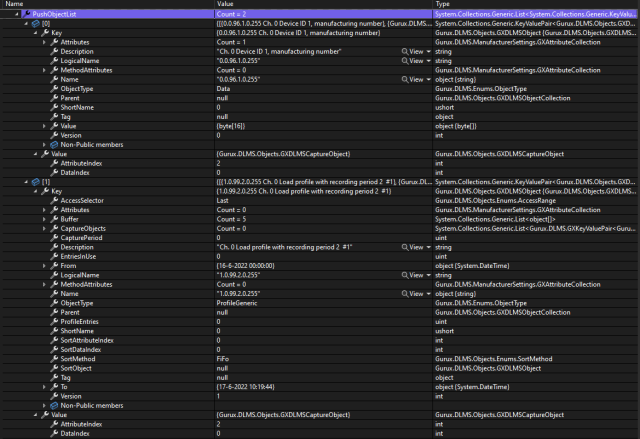

So I have managed to get the
So I have managed to get the above bit to work. But I am still fiddling around with converting the data to the correct data types.
What happens so far that I set the pushobject list with the expected object, as mentioned above.
GXDLMSPushSetup clone = (GXDLMSPushSetup)push.Clone();
clone.GetPushValues(client, (List<object>)notify.Value);
So after this I can see that the clone.PushObjectList has some values attached to it.
When I loop through them:
0 -> device id
1 -> GenericProfile
With the code from the example on github:
//Comment this if the meter describes the content of the push message for the client in the received data.
foreach (KeyValuePair<GXDLMSObject, GXDLMSCaptureObject> it in clone.PushObjectList)
int index = it.Value.AttributeIndex - 1;
Console.WriteLine(((IGXDLMSBase)it.Key).GetNames()[index] + ": " + it.Key.GetValues()[index]);
I get the following output:
Value: System.Byte[]
Buffer: System.Object[][]
Is there a way to further convert these data types? Do I have to set this up in the pushSetup? Or what is the way to do so?
Eventually I want to create an object, ideally with the obis codes, the values, the unit and timestamp and then pass it along to another system to further process it.
Attached a screenshot while debugging and checking the content of the clone.PushObjectList. Note I also used converter.UpdateOBISCodeInformation(it.Key); to update the description of the items in the pushObjectList.

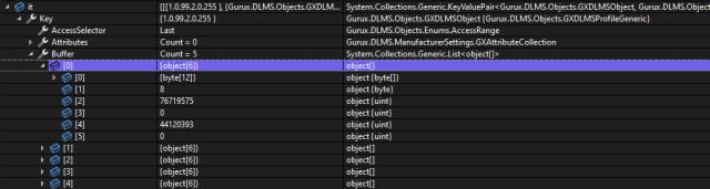

lagnem
4 years 1 month ago
Attached another screenshot
Attached another screenshot of what is currently in the buffer. These are the reading values. But I would like to enrich / convert this data to the correct data types and map with with the obis codes.
4 years 1 month ago
Get values returns the value as it is defined on the DLMS standard. You can convert the byte array to hex and loop through object arrays and then print them. Another option is that you check the object type and then print it something like this:
if (it.Key is GXDLMSClock clock)
if (it.Value.AttributeIndex == 2)
Console.WriteLine("Current time: " + clock.Time);
