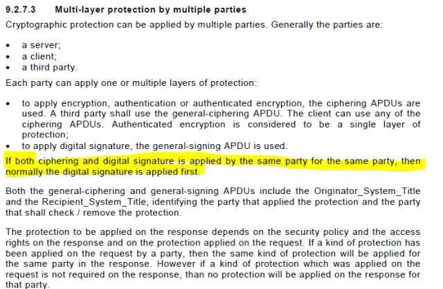

Also from the request of General signing generated by gurux i understand that:
1. It follows the general signing APDU structure.
2. first encryption is applied to the plane text then Digital signature is applied
but as per the green book "If both ciphering and digital signature is applied by the same party for the same party, then normally the digital signature is applied first"
also attached the snippet. also how it is decided that which type of APDU is to be used.
AP
4 years 2 months ago
Gurux client is working as a Client. There is no Third Party who will sign the messages. The client will do it.
You are right about this. Our clients are reading DLMS meters with general signing and those meters are adding digital signature last. I asked this from DLMS UA from this some time ago and I received an answer that NORMALLY the digital signature is applied first.
This is implemented in the same way as our clients have done it.
This makes it possible to remove digital signing and sign the message again without knowing block cipher or authentication keys. This can be used when 3rd party signing is used.
