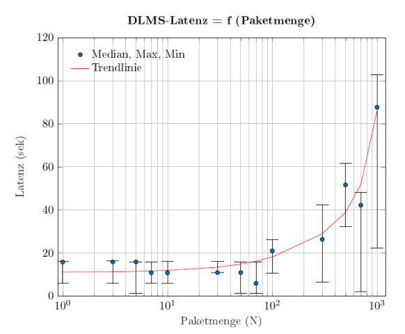

I have done some research. I could explain the big differences by timeouts in the TCP/IP connection (as you mentioned). However, is it possible that the garbage collection makes that much of a difference? I have a graph here for illustration with minimum, maximum and median delay as a function of packet size. I am generally amazed that communication takes so long (e.g. about 16 seconds when transmitting only one row).

The garbage collection might affect a little bit, but not so much. 16 seconds sounds a long time for reading a one row. I did test this and it takes about 6 ms to read one row.
