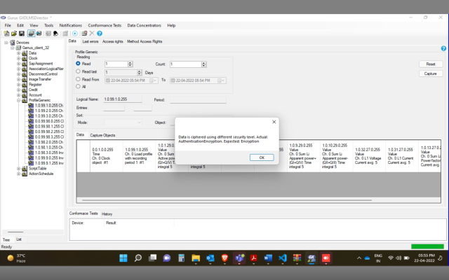

Thank you for your response.But i tried with GXDLMSDirector. I changed according you mentioned but not able to read profile.
4 years 3 months ago
Your security level is wrong. You need to use Encryption and not AuthenticationEncryption. Try to change that from the "Secured Connections" tab.
