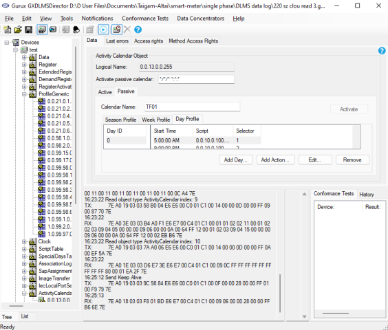

I'm trying to change tariff time but it says Device reports Read-Write denied
I tried high or gmac auth but it it says Devic reports a unmatched type
-S COM5:9600:8NoneOne -c 1 -a Low -P 00000000 -w 1 -f 248 -t Verbose
Writing object 0.0.13.0.0.255, interface ActivityCalendar
TX: 7E A0 47 03 03 54 88 B5 E6 E6 00 C1 01 C1 00 14 00 00 0D 00 00 FF 05 00 01 01 02 02 11 00 01 02 02 03 09 04 05 00 00 FF 09 06 00 00 0A 00 64 FF 12 00 01 02 03 09 04 15 00 00 00 09 06 00 00 0A 00 64 FF 12 00 02 9C A2 7E
20:32:38
RX: 7E A0 10 03 03 74 BD 16 E6 E7 00 C5 01 C1 03 CB BB 7E
4 years 8 months ago
You need to write day_profile_table to passive table and then activate the passive calendar.
Now you try to write active calendar directly.
https://www.gurux.fi/Gurux.DLMS.Objects.GXDLMSActivityCalendar
Purevnorov
I tried but activation button
I tried but activation button is not activating
and it says Active passive calendar - No access
You don't have enough access rights for the meter. You need to connect using High authentication.
