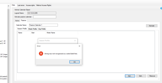

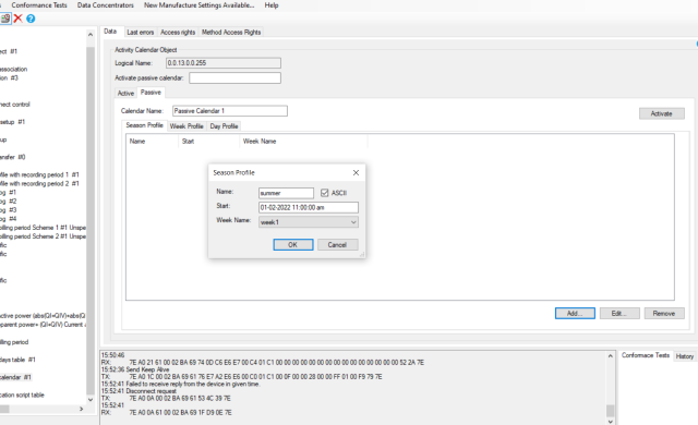

i am using Gurux GXDLMSdirector version 8.2.2202.0901 trying to add season profile in activity calendar
but not able to add season profile. it shows error i am using format bellow
start: 01-02-2022 11:00:00 am
week name : week1
but it shows error string was not recognized as a valid date time.
Rohit Patil
4 years 5 months ago
It shows error below while
It shows error below while adding
Your date-time string is not in the correct format. Try to read the clock object and use the same format. Windows is parsing the date-time and format is defined on your Windows settings.
