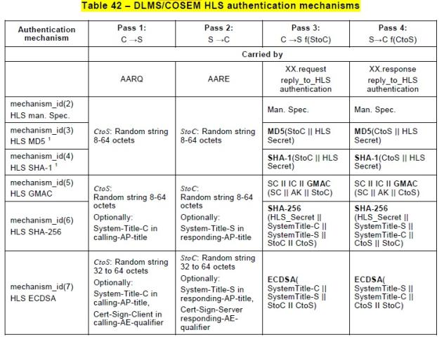

What is Input and Ouput of GMAC?
I am using LN_WITH_CIPHERING application association using the HIGH_SECURITY_GMAC authentication mechanism.
In 4 Pass method ,I am able to get PASS-1 and PASS-2 but not able to generate
PaSS-3 GMAC(SC||AK||SToC)
What is input required for GMAC generation. IS it diffrent ffrom GCM ?

It has been a long time since GMAC, but if I remember right, there is no hash in GCM and it's in GMAC.
You can use GCM if you are generating only Encryption and authentication is not used.
Client sends:
GMAC(SC||AK||SToC)
and if meter accepts it will reply:
GMAC(SC||AK||CToS)
https://www.gurux.fi/node/16639

I'm afraid that it's not so easy and you need to read High authentication steps from the DLMS standard.
That is something that I can't describe quite easily.

Hi Rajesh,
Hi Rajesh,
DLMS standard don't specify details of the HLS mechanism. Gurux libraries are using AES1 for High authentication. All High-level authentication mechanisms are using the same steps to verify the password. Only securing the challenge (random string) is different for each mechanism
You can read more about High Authentication here:
https://www.gurux.fi/DLMSCOSEMFAQ
