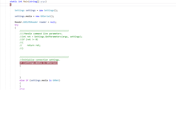

Am working in metering , task assigned to me learn DLMS protocol, I read books,
Now I want to learn DLMS meter data download, I have DLMS meter , I want to read it on serial port,
I have down loaded DLMS.net
1) Development
2) Gurux.DLMS.Client.Example.Net
Gurux DLMS .net I found one setting.cs Class and main program class,
Please send me some working code for program class settings,
I tried severl ways ,but no example code i find is working.
Please send me setting for read meter on serial port.

If you are new with DLMS I believe that the best way is if you download GXDLMSDirector and read your meter with it. It will give you an idea of what to do with the DLMS meter. It will also show command line parameters that you should use.
