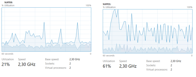

You have earlier had contact with Christer during development of suite1 for Sanxing meters. We have now deployed some of what we have done and see a big increase in CPU load on the machines. Could there be any issues in Gurux regarding this or do you think this is as expected?
I attach some screenshots of CPU load when running in suite0 and suite1(HLS7)
4 years 7 months ago
Sorry to say, but this is expected. HLS7 is more complicated than HLS5. I have read a lot for ECDSA and I have a few ideas that might help to decrease CPU usage. I'll send more information after I have received answers to my questions and verified that those ideas can be used for this.

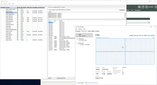

It's really bad now.

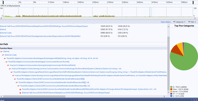

This is probably something
This is probably something you already know, but in case it can help. I ran a collection of values through a profiler and the "bad boy" seem to be GXDLM.ReceiverReady
This is a different scenario than I expected. Can you get the hex trace from the sent and received bytes and send it to me by email?
