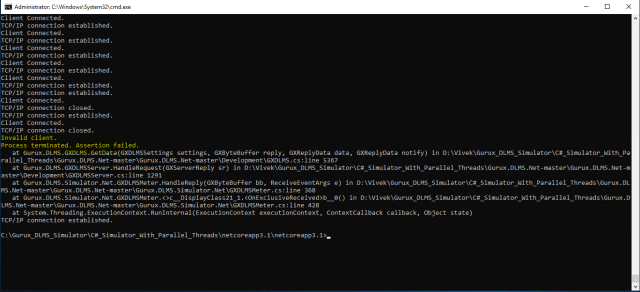

We are using Gurux DLMS Simulator for testing.
After reading for some meters (~50 meters), Gurux simulator stopped with assertion failed error.
Please check the attached image for reference.
Can you please provide your input on this.

Please, don't add a picure. It doesn't tell anything and it's hard to read. Are you using the same port for all the meters or is every meter using its own TCP/IP port? Can you share the command line parameters?

We are using same port for all the meters.
Following is the command line parameters :
Gurux.DLMS.Simulator.Net.exe -c 32 -p 5000 -X -N 1000 -x meter-template.xml

Each connected client must use a different client address or they connect to the same meter and it might cause problems. Can you check this?
