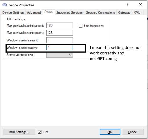

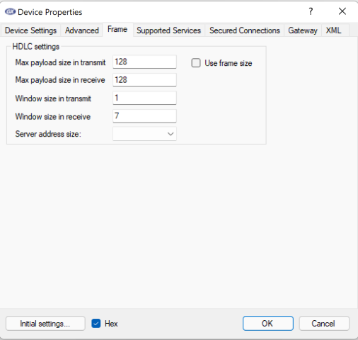

I checked command line
I checked command line parameter that you used , and notice that you use -W that is "General Block Transfer window size" and it's not "Window Size in Receive" that I mean.
I checked packets with -W parameter and noticed that, in this case ack sent for each received packet and not for 7 that is supposed.

sorry I'm asking again, but did you notice "General Block Transfer window size" and "Window Size in Receive" ?
when we set "GBT" to 7 , there is not difference in SNRM frame and <WindowSizeRX Value="1" /> does not change and every thing works ok, because ack sent for each packet separately.
but when setting WindowSizeRX = 7 in snrm packet, this component does not work correctly for first paket. (it sent ack after 5 instead of 7 packets). but in later packets it works correctly. and at end , it can't parse received packets correctly and generate error in this line :

The other application is using frame size 128 which is the default. You are using Tx value 117 and RX 114. Change them to default values and try to read again.
ali_bahal
4 years 9 months ago
it's because I use
it's because I use "UseFrameSize = true," in my setting. I tested without it, and nothing changed.
still the same error
There are several different parameters in DLMS and each affects communication. If one of your settings is different from the meter expect the communication might fail.
Set UseFrameSize to false. Then read the meter and add hex trace here so I can check from the bytes what is happening.

Hi, thank you for your reply.
But I think there is a missing part in your code. When we use meter own software to read it, it's send A8 after 7th packet and correctly does it.
But when we use gurux, this happens
I added meter own software packets also.
