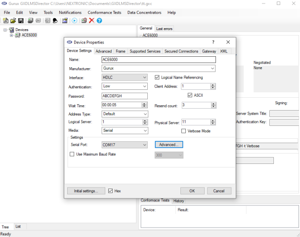

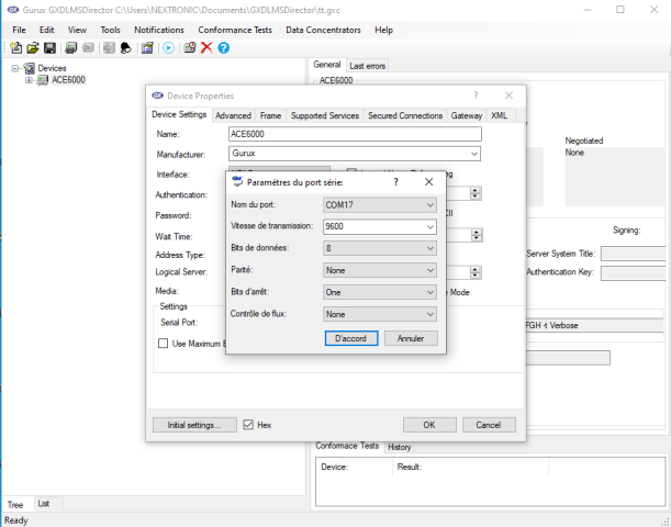

I'm trying to read data from smart meter ace6000 , i've been succeseful in reading its data from GXDirector so fat but when i try to establish connection with the meter using my mcu and the example provided i dont seem to manage to get it working .
the hardware connection is all good i tried reading the meter using the python library using my mcu as a proxy and it works however using the C library i seem to have some problem.
i'll join the logs plus the Gxdirector config i used
thank you for your support i hope of hearing back from you.
P.S: Forgot to include code snippet :

ACE6000 is a special case.
Change this:
Client.GetServerAddress(1,0x11,0)
to:
Client.GetServerAddress(1,0x11,4)
