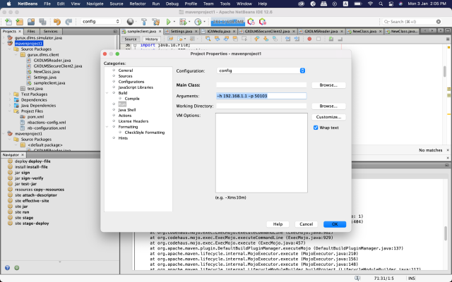

4 years 8 months ago
You need to set command line parameters for the Netbeans. Select Properties and then select Run. Add those command-line arguments for the "Arguments" text box.
nomanimran
please check my properties
You need to select Run, not Configurations, and then set run time command-line arguments.

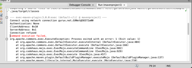

Now Connection refused

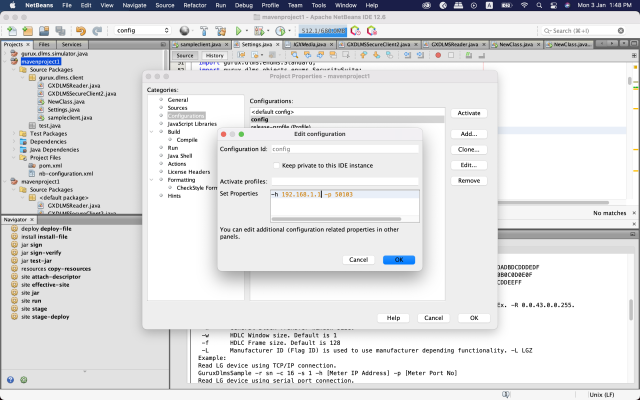

nomanimran
here is my Argument
here is my Argument
Connection refused means that your IP address or port number is invalid.
That is TCP/IP error.

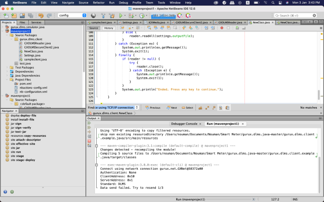

nomanimran

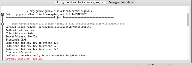

Now it is responding Data
Now it is responding Data send failed. Try to resend 1/3
But with GXDLMSDirector it is working fine and getting data from meter is also perfectly fine
Please, don't add pictures. They are hard to read. Plain text is better. One of your settings is wrong.
Select this meter from GXDLMSDirector. You can see the command line parameters. Use them.
