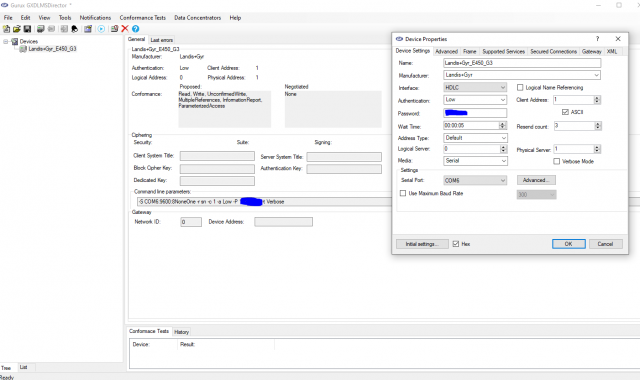

Is anything wrong with the command? Then when I am doing the same with the GXDLMSDirector, it works fine! (See picture)
My Hardware:
SmartMeter: Landis+Gyr E450
Optical Probe
Thanks a lot for any help! :)

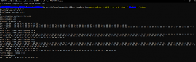

I just tried again to get a
I just tried again to get a slightly different message.
Unknown object : 30035 52640
Unknown object : 30307 59480
What does this mean?
4 years 10 months ago

Please, add plain text and not pics. Reading bytes is pain from the image. Textual data is different than in the pic. Can you add the whole trace as a text?

TX: 17:29:54 7E A0 44 03 03 10 65 94 E6 E6 00 60 36 A1 09 06 07 60 85 74 05 08 01 02 8A 02 07 80 8B 07 60 85 74 05 08 02 01 AC 0A 80 08 31 32 33 34 35 36 37 38 BE 10 04 0E 01 00 00 00 06 5F 1F 04 00 1C 03 20 FF FF 88 81 7E
RX: 17:29:54 7E A0 44 03 03 10 65 94 E6 E6 00 60 36 A1 09 06 07 60 85 74 05 08 01 02 8A 02 07 80 8B 07 60 85 74 05 08 02 01 AC 0A 80 08 31 32 33 34 35 36 37 38 BE 10 04 0E 01 00 00 00 06 5F 1F 04 00 1C 03 20 FF FF 88 81 7E 7E A8 25 03 03 30 18 6A E6 E7 00 61 29 A1 09 06 07 60 85 74 05 08 01 02 A2 03 02 01 00 A3 05 A1 03 02 01 00 A6 AE 7E
TX: 17:29:54 7E A0 07 03 03 31 94 97 7E
RX: 17:29:54 7E A0 07 03 03 31 94 97 7E 7E A0 1B 03 03 32 9A F1 BE 10 04 0E 08 00 06 5F 1F 04 00 1C 02 20 05 DC FA 00 E2 E8 7E
TX: 17:29:54 7E A0 11 03 03 52 32 4E E6 E6 00 05 01 02 FA 08 18 9E 7E
RX: 17:29:55 7E A0 11 03 03 52 32 4E E6 E6 00 05 01 02 FA 08 18 9E 7E 7E A8 75 03 03 54 2C 9A E6 E7 00 0C 01 00 01 82 01 3B 02 04 10 E7 08 12 75 4F 11 00 09 06 00 00 C7 1D 00 FF 02 04 10 D9 38 12 75 4A 11 01 09 06 00 00 C7 0D 00 FF 02 04 10 DA 48 12 75 38 11 00 09 06 00 00 C7 17 00 FF 02 04 10 DC F0 12 00 06 11 00 09 06 00 00 0E 00 02 FF 02 04 10 DC 68 12 00 06 11 00 09 06 00 00 0E 00 01 FF 02 04 10 D2 50 12 00 09 D0 42 7E
TX: 17:29:55 7E A0 07 03 03 71 90 D5 7E
RX: 17:29:55 7E A0 07 03 03 71 90 D5 7E 7E A8 72 03 03 56 1F EE 11 00 09 06 00 01 0A 00 6A FF 02 04 10 D1 C8 12 00 09 11 00 09 06 00 00 0A 00 64 FF 02 04 10 D1 40
Unknown object : 30031 59144
Unknown object : 30026 55608
Unknown object : 30008 55880
File "main.py", line 98, in main
reader.getAssociationView()
File "C:\Users\Manuel\Desktop\Serial DLMS Test\python\Gurux.DLMS.Python\Gurux.DLMS.Client.Example.python\GXDLMSReader.py", line 515, in getAssociationView
self.client.parseObjects(reply.data, True, False)
File "C:\Users\Manuel\anaconda3\lib\site-packages\gurux_dlms\GXDLMSClient.py", line 732, in parseObjects
objects = self.parseSNObjects(data, onlyKnownObjects, ignoreInactiveObjects)
File "C:\Users\Manuel\anaconda3\lib\site-packages\gurux_dlms\GXDLMSClient.py", line 687, in parseSNObjects
raise Exception("Invalid structure format.")
Exception: Invalid structure format.

unfortunately I still get an error message. What am I doing wrong?
Manuel
C:\Users\Manuel\Desktop\SmartMeter\Gurux.DLMS.Python\Gurux.DLMS.Client.Example.python>python main.py -S COM8 -r sn -c 1 -s 1 -a Low -P 12345678 -g "0.0.42.0.0.255:2" -t Verbose
gurux_dlms version: 1.0.112
gurux_net version: 1.0.18
gurux_serial version: 1.0.18
ClientAddress: 0x1
Standard: Standard.DLMS
TX: 16:20:12 7E A0 07 03 03 93 8C 11 7E
RX: 16:20:12 7E A0 07 03 03 93 8C 11 7E 7E A0 1E 03 03 73 40 CC 81 80 12 05 01 80 06 01 CA 07 04 00 00 00 01 08 04 00 00 00 01 30 7E 7E
TX: 16:20:12 7E A0 44 03 03 10 65 94 E6 E6 00 60 36 A1 09 06 07 60 85 74 05 08 01 02 8A 02 07 80 8B 07 60 85 74 05 08 02 01 AC 0A 80 08 31 32 33 34 35 36 37 38 BE 10 04 0E 01 00 00 00 06 5F 1F 04 00 1C 03 20 FF FF 88 81 7E
Invalid HDLC Frame: 0x10 Expected: 0x30
RX: 16:20:12 7E A0 44 03 03 10 65 94 E6 E6 00 60 36 A1 09 06 07 60 85 74 05 08 01 02 8A 02 07 80 8B 07 60 85 74 05 08 02 01 AC 0A 80 08 31 32 33 34 35 36 37 38 BE 10 04 0E 01 00 00 00 06 5F 1F 04 00 1C 03 20 FF FF 88 81 7E 7E A8 25 03 03 30 18 6A E6 E7 00 61 1F A1 09 06 07 60 85 74 05 08 01 02 A2 03 02 01 01 A3 05 A1 03 02 01 01 37 41 7E
TX: 16:20:12 7E A0 07 03 03 31 94 97 7E
RX: 16:20:12 7E A0 07 03 03 31 94 97 7E 7E A0 11 03 03 32 34 2D BE 06
File "main.py", line 88, in main
reader.initializeConnection()
File "C:\Users\Manuel\Desktop\SmartMeter\Gurux.DLMS.Python\Gurux.DLMS.Client.Example.python\GXDLMSReader.py", line 311, in initializeConnection
self.client.parseAareResponse(reply.data)
File "C:\Users\Manuel\anaconda3\lib\site-packages\gurux_dlms\GXDLMSClient.py", line 558, in parseAareResponse
self.isAuthenticationRequired = _GXAPDU.parsePDU(self.settings, self.settings.cipher, reply, None) == SourceDiagnostic.AUTHENTICATION_REQUIRED
File "C:\Users\Manuel\anaconda3\lib\site-packages\gurux_dlms\_GXAPDU.py", line 638, in parsePDU
cls.validateAare(settings, buff)
File "C:\Users\Manuel\anaconda3\lib\site-packages\gurux_dlms\_GXAPDU.py", line 624, in validateAare
tag = buff.getUInt8()
File "C:\Users\Manuel\anaconda3\lib\site-packages\gurux_dlms\GXByteBuffer.py", line 290, in getUInt8
value = self._data[index] & 0xFF
IndexError: bytearray index out of range
