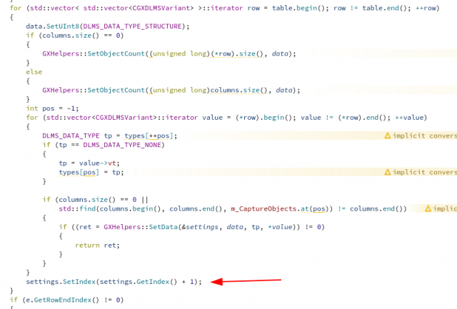

For debug i commented row
For debug i commented row with code:
settings.SetIndex(settings.GetIndex() + 1);
(see attached image)
in method int CGXDLMSProfileGeneric::GetData(
CGXDLMSSettings& settings,
CGXDLMSValueEventArg& e,
std::vector< std::vector<CGXDLMSVariant> >& table,
std::vector<std::pair<CGXDLMSObject*, CGXDLMSCaptureObject*> >& columns,
CGXByteBuffer& data)
And all rows show in DLMSDirector OK.
But i don't shure is it correct fix.
4 years 10 months ago
Thank you for this info. I can repeat this and I know the reason. Your fix will solve this with your data, but it might cause problems when you have a lot of rows. Access service works with simple COSEM objects, but Profile Generic is causing problems. I need to think about this a little bit.
You can fix this temporarily if you remove Access conformance bit from server like this:
SetConformance((DLMS_CONFORMANCE) (GetConformance() & ~DLMS_CONFORMANCE_ACCESS));
Or then you un-check the Access From Supported Services -tab in GXDLMSDirector.
