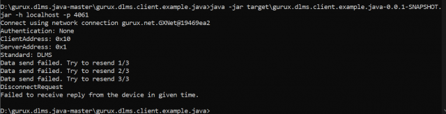

4 years 10 months ago
I passed the client parameters as you asked. After passing these parameters, it is failing to send the data and shows the output shown in the screenshot attached. How should I fix this?
PS: The server showed Client connected when I ran the command with client parameters.
Thanks for helping and looking forward to a response.
The security was improved in the last version and one setting was not updated to the server example. Get the latest version from the server example from the GitHub. You need also to remove 406Xsettings.xml files from the target folder.
nakul_gupta
In the server example, there is a method invocation of setMinimumInvocationCounter(long) and getMinimumInvocationCounter(). These two methods are giving a compilation error as these are not available for the class GXICipher. I checked the documentation of GXICipher and these methods are not present there too. So can I comment these out before running the program?
I'm sorry. The new version is still on testing and that is the reason why it failed. Get the latest version from GitHub. This is commented out until the next version is released.

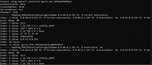

nakul_gupta
Following is the client
Following is the client output.

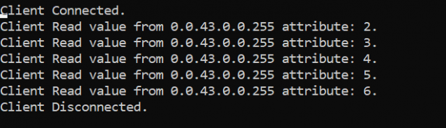

nakul_gupta
Sorry for the inconvenience. Following are the client and server output, respectively:
Client Output:
Connect using network connection gurux.net.GXNet@19469ea2
Authentication: None
ClientAddress: 0x10
Standard: DLMS
-------- Reading GXDLMSAssociationLogicalName 0.0.40.0.0.255 Ch. 0 Current association
Index: 2 Value: 0.0.40.0.0.255 Ch. 0 Current association, 0.0.40.0.1.255 Ch. 0 Association #1, 0.0.43.0.0.255 Ch. 0 Security setup #0
Index: 3 Value: 16/1
Index: 4 Value: 2 16 756 5 8 1 LOGICAL_NAME
Index: 5 Value: [GET] 1024 0 6 0
Index: 6 Value: 2 16 756 5 8 2 None
Index: 7 Value: 47 75 72 75 78
Index: 8 Value: ASSOCIATED
Index: 9 Value: 0.0.43.0.0.255
Index: 10 Value:
Index: 11 Value: gurux.dlms.GXSimpleEntry@694f9431
-------- Reading GXDLMSAssociationLogicalName 0.0.40.0.1.255 Ch. 0 Association #1
Index: 10 Value:
Index: 11 Value: gurux.dlms.GXSimpleEntry@f2a0b8e
-------- Reading GXDLMSSecuritySetup 0.0.43.0.0.255 Ch. 0 Security setup #0
Index: 2 Value: []
Index: 3 Value: SUITE_0
Index: 4 Value:
Index: 5 Value: 41 42 43 44 45 46 47 48
Index: 6 Value:
Server Ouput:
Client Connected.
Client Read value from 0.0.43.0.0.255 attribute: 2.
Client Read value from 0.0.43.0.0.255 attribute: 3.
Client Read value from 0.0.43.0.0.255 attribute: 4.
Client Read value from 0.0.43.0.0.255 attribute: 5.
Client Read value from 0.0.43.0.0.255 attribute: 6.
Client Disconnected.
Can you please explain these outputs? And about the server configuration, I haven't changed anything in the server example, so I am not sure if it is pre-configured to do that or not.
I believe that you should install GXDLMSDirector and read your meter with it. In that way, you get an idea of DLMS meters and how they operate.
