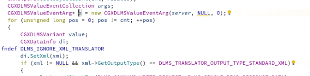

Hi!
I write test program server side DLMS.cpp.
I created CGXDLMSClock object and add it to CGXDLMSObjectCollection.
Then i try read clock from DLMSDIrector. Read first time - ok, second time - my program crashed.
I think error in int CGXDLMSLNCommandHandler::HandleAccessRequest() method.
pointer *e allocates memory out of loop single time, push_back() to args several times (8 for clock) in loop and when function body ends destructor of CGXDLMSValueEventCollection several times delete memory of *e which allocated single time.
When i row
CGXDLMSValueEventArg* e = new CGXDLMSValueEventArg(server, NULL, 0);
moved to begin of loop - no crashes.
Am I right?
Tested on Linux Mint 20.2, 64 bit
Thanks!
5 years ago
Hi Dmitry,
Hi Dmitry,
Thank you for this info. I created a ticket from this and it's fixed today.
http://www.gurux.fi/node/19026
