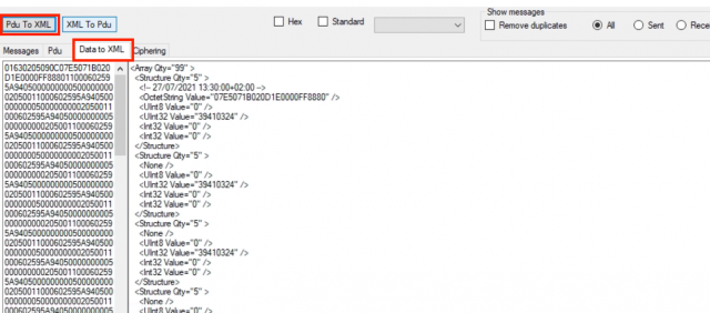

I have to make a translator of the data already extracted from a meter in python but I am not being able to achieve it, in the translator located on the web I am not able to translate the frame, but in the Gurux DLMS Translator I can, specifically in the Data to XML tab -> Pdu To XML.
This is the code I am using to translate it and the frame.

Shouldn't you use datatoXml? In that case, what function of the agrees with the options of the Gurux DLMS Director.
Thanks for your help

I'm sorry. I don't understand what is the problem. You should use dataToXml.
Try this:
bb = GXByteBuffer()
bb.setHexString(data);
t = GXDLMSTranslator()
print(t.dataToXml(bb))
I tested this with your data and it worked as expected.

Hi, Thank you, works perfect.
