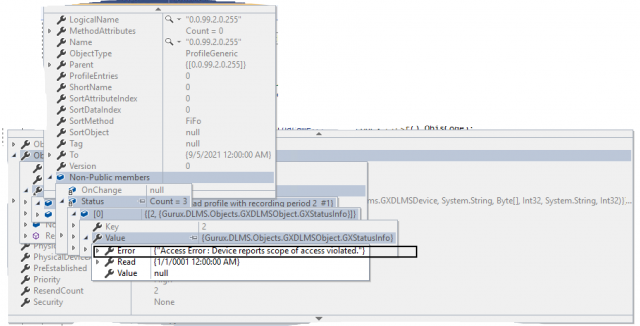

Hi, when I am reading Load profile of meter, it returns zero for buffer array of load survey and it's like this, every thing is Ok and only there isn't data in meter for load profile.
but when I look into non-public property of object that I read, I see there is "status" field with
error inside it.
how can I access to property ?

I find. I can use
I find. I can use
o.GetLastError(2);
for this. thank you .
