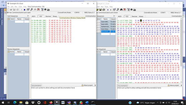

But when I see the traffic capture, it is one byte less than the data sent by the DLMS Director app.
I have tried different client addresses, server addresses, password, authentication bytes, but still there is a small discrepancy between the SNRM request sent by the DLMS Director to the example client application.
From the Screenshot (231).png in the attachment:
the left window is for the traffic from the C client library, the right side is from the DLMS Director app.
Questions:
1. Is there any tool to decipher the byte streams of DLMS / COSEM protocol?
2. Why is there 9 bytes sent by the C client libary versus 10 bytes from the DLMS Director Windows Application?

I apologize for the inconvenient, sending picture only. Now I copy the numbers as below:
Traffic capture from DLMS Director:
Tx: 7E A0 08 02 47 09 93 62 EF 7E
Rx: 7E A0 21 09 02 47 73 31 1A 8180 14 05 02 01 60 06 02 01 60 07 04 00 00 00 01 08 04 00 00 00 01 DE 89 7E
We can see there is a response from the meter.
From C Client example library:
Tx: 7E A0 07 03 21 93 0F 01 7E
Tx: 7E A0 07 03 09 93 FC EC 7E
Tx: 7E A0 07 47 03 93 9B 74 7E
And there is no response from the EDMI meter.

Hi Edy,
Thank you for sending the bytes in text format. It's easier to read and handle.
1. You can use http://gurux.fi/GuruxDLMSTranslator
2. You need to set Logical address to 1, Physical address to 35 and client address to 4.
Like this:
cl_init(&settings, 1, 4, cl_getServerAddress(1, 35, 0), DLMS_AUTHENTICATION_NONE, NULL, DLMS_INTERFACE_TYPE_HDLC);

thank you for your information, now I can access the e-meter using the example Client application, running on Windows 10 Platform.
