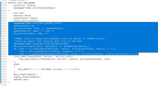

I am requesting Instantaneous profile in profile generic(1.0.94.91.0.255) with attribute index 3 which is for capture objects.
I am getting response from meter but as shown in attached image it shows error DLMS_ERROR_CODE_INCONSISTENT_CLASS_OR_OBJECT.

The problem is cl_updateValue-method. You can't call it when you read profile generic. It will try to update the profile generic buffer and because it's empty, it can't be updated.
You need to parse reply.DataValue by yourself when you read profile generic buffer.

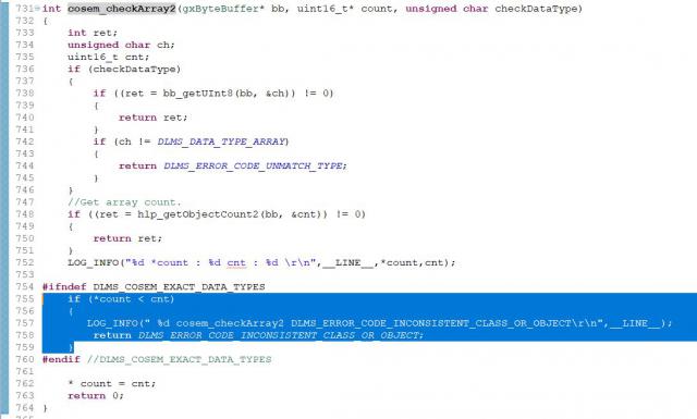

I am sorry for late response. Recently I resolved my issue by myself. I want to inform you regarding the same.
I found two root causes.

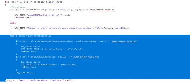

RCA 1)
I found that while requesting Instantaneous profile with index 3 which is for capturing all supported objects, it was required to request 2 times, but I have commented the logic of request-response for second time(screen shot1 attached).
So It was failing to set value of capture objects, which I got from response of first request.(This is due to my mistake).

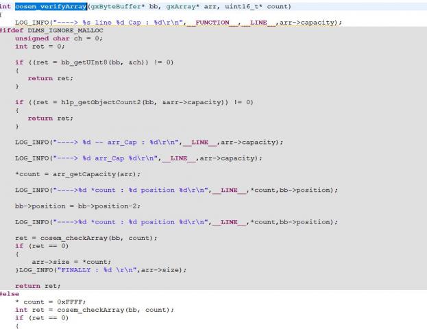

RCA 2)
After enabling the logic of request-response for second time, It was requesting the remaining object list and got same too. But while setting the list of object using cl_updateValue-method function, it was failing in static memory implementation of cosem_verifyArray(screen shot2 attached).I have added logic to get capacity of array and assign same size of memory to array. I have also tested the same and Now it is working fine.
After getting capture object list and setting them too, I requested index 2 for instantaneous Profile. But for that, I found there is no implementation for static memory.
So that I need to implement on my own. So I got your suggestion now and all doubts are clear now.
