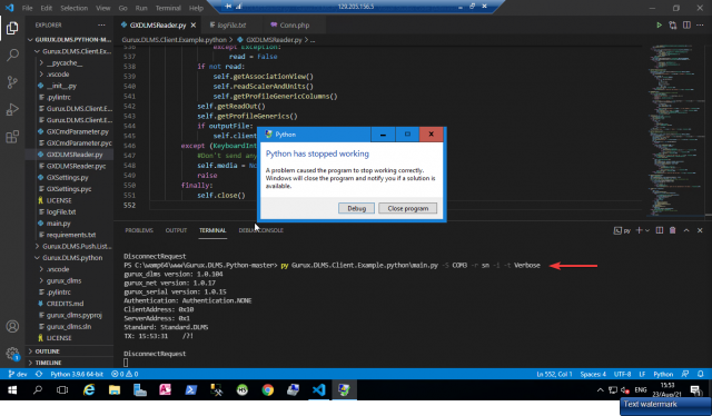

I am still having trouble. Let me give you some extra details and maybe it would help us resolve this.
I am currently using remote access to log onto a server that has the Landis+gyr unit connected up via the Kocos optical cable. Now, this is not my server and there are some existing programs on there that might not be up to date.
I see they have python 2.7 and I have recently installed Python 3.9. When I run some commands, like the last one you mentioned, Python seems to crash. I will attach a screenshot.
Besides the occasional crash, the unit does not respond.

When I run the comment in a terminal outside of VS code, I get a Segmentation Error. Which I believe means that Python does not have permission to access the COM port. Do you perhaps know a way around this?

The reason why I believe that this is a driver issue is that python crash. GXDLMSDirector is handling serial ports differently than Python. There is no native support for serial ports in Python.
I believe that you don't receive any reply from the meter and the application crashes when the close is called.
Can you try to comment on this line in close?
self.media.close()
Is the app still crashing?
DylanClark
4 years 10 months ago
I commented that line out (Line 103 - GXDLMSReader.py) and the app stopped crashing. I still get "Failed to received reply from the media."

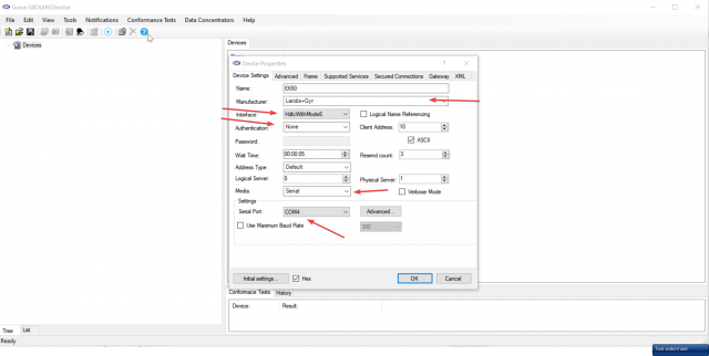

Okay great. I do not have WSL enabled. I use HdlcWithModeE on the director and in the Python commands.
I have attached a screenshot of the settings I change when using the Director
Regards,
Dylan

I need to verify that you are running Python from the command line? Have you tried to start the command line with elevated privileges?
DylanClark
I have been running it from the terminal, inside Visual Studio Code. I have tried from the command line run as administrator. But I have not tried from the command line many times. I will try some different commands you have suggested in the command line as an administrator.
Note: I am running with Python3.9 is this alright?
Regards,
Dylan
Hi Dylan,
Hi Dylan,
Python 3.9 is OK.
DylanClark
I got this in terminal this morning when testing:
$ python -Xfaulthandler Gurux.DLMS.Client.Example.python/main.py -S COM3 -r sn -i HdlcWithModeE -t Verbose
Windows fatal exception: access violation
Current thread 0x000043fc (most recent call first):
File "C:\Users\Dylan\AppData\Local\Programs\Python\Python37\lib\linecache.py", line 95 in updatecache
File "C:\Users\Dylan\AppData\Local\Programs\Python\Python37\lib\linecache.py", line 47 in getlines
File "C:\Users\Dylan\AppData\Local\Programs\Python\Python37\lib\linecache.py", line 16 in getline
File "C:\Users\Dylan\AppData\Local\Programs\Python\Python37\lib\traceback.py", line 285 in line
File "C:\Users\Dylan\AppData\Local\Programs\Python\Python37\lib\traceback.py", line 363 in extract
File "C:\Users\Dylan\AppData\Local\Programs\Python\Python37\lib\traceback.py", line 508 in __init__
File "C:\Users\Dylan\AppData\Local\Programs\Python\Python37\lib\traceback.py", line 104 in print_exception
File "C:\Users\Dylan\AppData\Local\Programs\Python\Python37\lib\traceback.py", line 163 in print_exc
File "Gurux.DLMS.Client.Example.python/main.py", line 112 in main
File "Gurux.DLMS.Client.Example.python/main.py", line 124 in <module>
Segmentation fault
Could this be related to the problem?
Regards,
Dylan
This looks more and more like a driver issue, but there is one change in the client example that might help to solve this. Get the latest version from the client example and give it a try.
DylanClark
I got the latest version client example and the result is more or less the same:
Current thread 0x00003cd8 (most recent call first):
File "Gurux.DLMS.Client.Example.python/main.py", line 125 in <module>
Segmentation fault

Segmentation fault
Sorry for the long post. Should I try looking for different driver versions?
Regards,
Dylan
Try to remove your driver and let Windows find the driver. It should be 2.12.28.0.
Let me know if it still fails. Do you have any specific in your PC?
DylanClark
I removed the driver and it rolled back to version 2.12.28.0 Before it was a new version. Python seems to crash a lot less but still no success. I'm going to try a system restart just to see what happens.
Regards,
Dylan
DylanClark
Still no luck on my side. I'm still getting the same errors.
DylanClark
If I send through a file with full Python traceback, would that help to debug my issue?
The new version is released (1.0.109). Get the source codes from the GitHub. Note! You must update gurux-serial component for Python to version 1.0.15.
DylanClark
Hi MIkko
Hi MIkko
I have updated the serial component for Python, and I got the latest code from Github. It's definitely progress but Still 100%.
I tried: py main.py -S COM3 -r sn -i HdlcWithModeE -t Verbose
Response:
gurux_dlms version: 1.0.107
gurux_net version: 1.0.17
gurux_serial version: 1.0.17
ClientAddress: 0x10
Standard: Standard.DLMS
TX: 12:21:21 /?!
RX: 12:21:22 bytearray(b'/LGZ5\\2ZMD3104407.B24\r\n')
Bitrate is : 9600
TX: 12:21:23 06 32 35 32 0D 0A
RX: 12:21:24 None
TX: 12:21:25 7E A0 07 03 21 93 0F 01 7E
RX: 12:21:25
Invalid Interface type.
Regards,
Dylan
DylanClark
Hi Mikko
Hi Mikko
I have successfully connected to the meter with this command:
py main.py -S COM3 -r sn -t Verbose
I did not need to specify an InterfaceType

I find the code hanging sometimes. I have to restart the terminal.
$ py main.py -S COM3 -r sn -i HdlcWithModeE -t Verbose
File "C:\wamp64\www\personal\projects\Gurux.DLMS.Python-master\Gurux.DLMS.Client.Example.python\main.py", line 108, in main
File "C:\wamp64\www\personal\projects\Gurux.DLMS.Python-master\Gurux.DLMS.Client.Example.python\GXDLMSReader.py", line 528, in readAll
self.initializeConnection()
File "C:\wamp64\www\personal\projects\Gurux.DLMS.Python-master\Gurux.DLMS.Client.Example.python\GXDLMSReader.py", line 301, in initializeConnection
self.initializeOpticalHead()
File "C:\wamp64\www\personal\projects\Gurux.DLMS.Python-master\Gurux.DLMS.Client.Example.python\GXDLMSReader.py", line 199, in initializeOpticalHead
if not self.media.receive(p):
File "C:\Users\Dylan\AppData\Local\Programs\Python\Python39\lib\site-packages\gurux_serial\GXSerial.py", line 385, in receive
return self.__syncBase.receive(args)
File "C:\Users\Dylan\AppData\Local\Programs\Python\Python39\lib\site-packages\gurux_serial\_GXSynchronousMediaBase.py", line 243, in receive
foundPosition = self.__findData(args)
File "C:\Users\Dylan\AppData\Local\Programs\Python\Python39\lib\site-packages\gurux_serial\_GXSynchronousMediaBase.py", line 193, in __findData
isReceived = self.__receivedEvent.wait(waitTime / 1000)
File "C:\Users\Dylan\AppData\Local\Programs\Python\Python39\lib\threading.py", line 574, in wait
signaled = self._cond.wait(timeout)
File "C:\Users\Dylan\AppData\Local\Programs\Python\Python39\lib\threading.py", line 316, in wait
gotit = waiter.acquire(True, timeout)
KeyboardInterrupt
