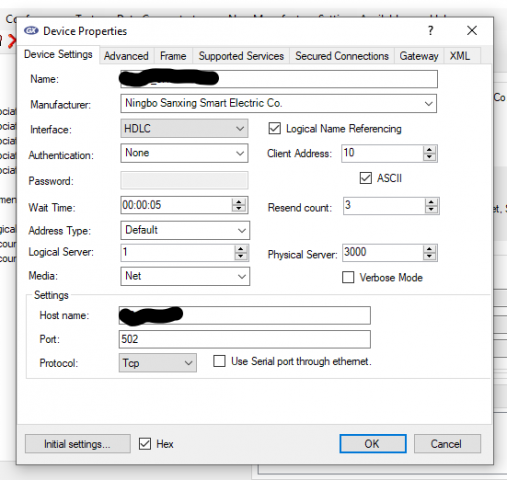

I am using same settings on both .net client and gxdlmsdirector. However, .net client can't connect to the meter.
Meter brand is sanxing.
Please see the attachment for the settings and below for .net code:

Your client address is wrong. It should be 0x10. Your server address is also different. You can count it like this:
_dlmsSettings.Client.ServerAddress = GXDLMSClient.GetServerAddress(0x3000, 1);
Check also your wait time.

It worked with GXDLMSClient
It worked with GXDLMSClient.GetServerAddress(1, 12288);
12288 is the number replaced by 3000 when I unchecked hex on GXDLMSDirector.
5 years 1 month ago
Hi Aaron,
Hi Aaron,
Thank you for the information. I forget to add 0x. I'll add it now.
