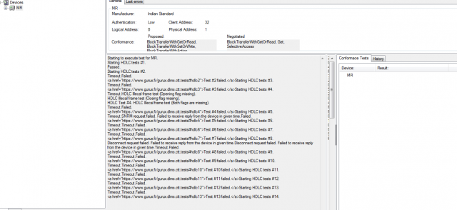

When I am running CTT test on gurux client it is showing timeout, timeout failed. for all HDLC tests.
please help me where i am wrong.
5 years ago
I believe that you are not doing anything wrong because the first test pass. Test number 2 failed because the meter can't reply after one byte is removed from the DisconnectRequest and it seems that the meter can't handle this. Ask the meter manufacturer to check this.
