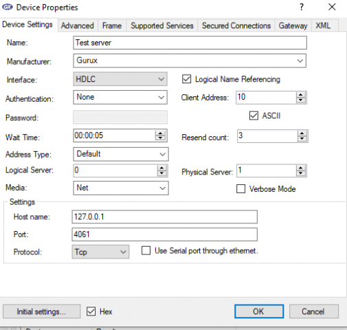

I have simply downloaded the source code from https://github.com/Gurux/Gurux.DLMS.cpp. Then I have built it with VS Community 2019 and have ran the GuruxDLMSServerExample. I didn't add any of my code.
After that I add new device to the DLMS Director. You can see the configuration of DLMS Director on the screenshot below.
The reading works on Data objects and doesn't work (the exception which I described above occurs) for example on Clock, Register, IecHdlcSetup and Security Setup objects.

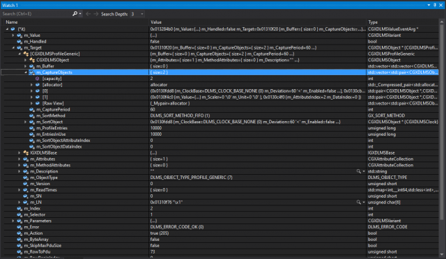

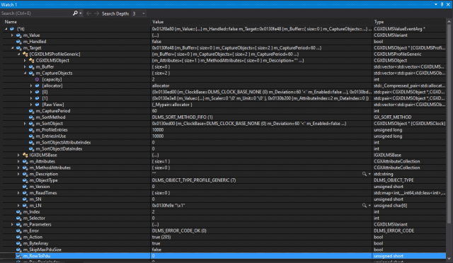

Got the same bug while read
Got the same bug while read profile generic on ServerExample, old version of GuruxCGXDLMSDirector reads data normaly, and new version sends incorrect request to server or server unable correct handle request data, such as m_RowToPdu and m_Selector always equal 0.

Hi, i am trying to read by
Hi, i am trying to read by range (in default it "read last 0 days")
