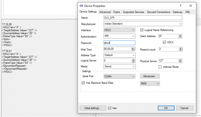

Yup, Broadcast to use for specific operations like Disconnect/Connect meter relay.
I have set 127 (0x7F) in the server physical address using GXDLMSDirector.
SNRM request was sent but did not receive any response from the meter.
I have attached a configuration screenshot. Please have a look
Regards
Bhaumik
5 years ago
Your meter doesn't support broadcast. You need to connect to each meter individually.
