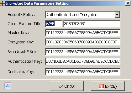

I've Wasion aMeter300 with High GMAC authentication. When I using Wasion's
MPMS3000 software, I can read values. But cannot read using Gurux dlms director.
the connection is established but cannot read Association view. please check below log and help us to resolve the problem or misconfig. I've tried almost all options with no success.
Here is log of MPMS3000:

Here is the log of DLMS Director:
BlockCipher key:
Authentication Key:
1: 7E A0 07 03 03 93 8C 11 7E

5 years 1 month ago
Because messages are ciphered and I don't have a block or authentication key, I can't read the bytes.
bayasgalan
5 years 1 month ago
cypher key:
cypher key: 000102030405060708090A0B0C0D0E0F
Auth key: D0D1D2D3D4D5D6D7D8D9DADBDCDDDEDF
Master key: 00112233445566778899AABBCCDDEEFF
5 years 1 month ago
It looks like the association view is not implemented for High GMAC authentication. Meter returns a simple error. You need to ask the meter vendor if there is new firmware available. You can also try to read the association view with some other authentication level and after you have the association view, change authentication to High. You can also add objects manually by selecting "Edit" menu and then "Add Object.."
